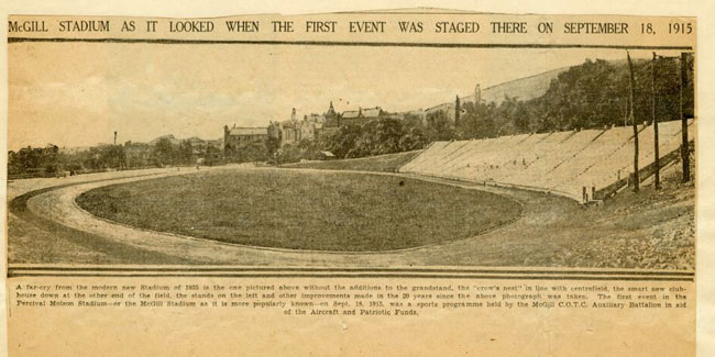

BTW, this is what the Alouettes stadium looked like when it was new. I think it's fair to say it's not all that old.
